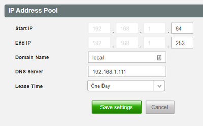

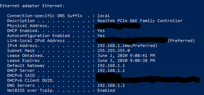

Hello, I have the new Telus Wifi Hub gateway and I am trying to set it up so that it configures connected clients to use a local DNS server that I have in my LAN. I go to Network > LAN and change the DNS Server address to a local IP on my network, however, when I connect devices, they still get configured with the gateway (In my case 192.168.1.1) as the DNS server. I've restarted gateway and computer and I have also released and renewed ip to no avail.

      That does not work. The TELUS Wi-Fi Hub will always have a DNS resolver running on its LAN IP, that DNS resolver will always bypass *any* upstream IPv4 or IPv6 DNS that you defined in its config (you have the right steps in your article), and finally the LAN IP of the Wi-Fi hub will always get pushed as the primary DNS server by the built-in DHCP server.
      Basically, you can set *all* of your home devices with custom DNS settings in order to bypass the Telus Wi-Fi hub, or you can set the hub in Bridge mode and use another device as your ethernet + wifi router.

      I set 10.0.2.10 as *both* the WAN DNS and the LAN DNS, I save the config, reboot the TELUS Wi-Fi Hub, reboot all my client devices.
      Every single Windows computer in the house, and gaming console will always get 10.0.2.1 pushed as its *only* IPv4 DNS, every time, effectively bypassing my Pi-Hole DNS. Oddly, this does not apply for IPv6 cliients, however not all of my home devices can do IPv6-only.
      Simple dig commands run from any computer on my home LAN show that my findings are correct :
