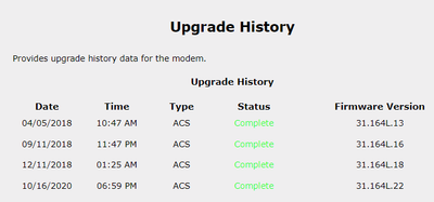

  • My T3200M hasn't hasn't had an update in 2 years, that sounds wrong.
    I work for TELUS just not the department that goes to peoples houses.
