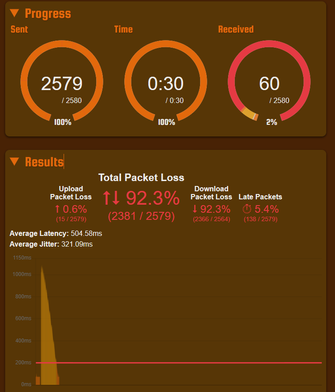

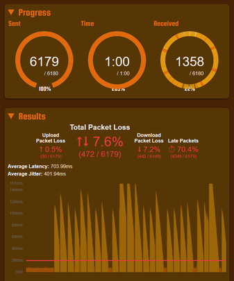

Extreme Packet Loss / Late Packet Issues every few days?
Hi all,
Every few days (sometimes multiple times a day), packet loss will go through the roof. This affects things like Facetime, Zoom, and even games and has been extremely inconvenient. A reboot of the router fixes the issue, but only temporarily. I haven't been able to try over ethernet, but the problem definitely happens across multiple devices all at the same time. It also tends to resolve itself a few hours later?
See attached images for packet issue examples. Have plenty more...
