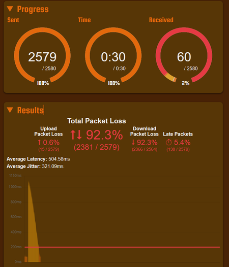

Extreme Packet Loss / Late Packet Issues every few days?
Hi all, Every few days (sometimes multiple times a day), packet loss will go through the roof. This affects things like Facetime, Zoom, and even games and has been extremely inconvenient. A reboot o...
