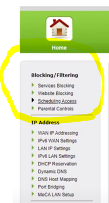

I have also lost the parental controls. I have actually lost all the Blocking/Filtering section seen here circled in yellow:
I am currently on the phone holding in the 1 hour support queue to see why this is happening and if it can be resolved.
