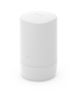

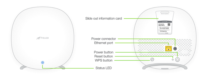

    Hey Sedum2026​ - Are these Boosters that you will have soon the first generation of Wi-Fi Boosts? I'll attach some pictures to clarify.
    These are the v1 "Wi-Fi Boosts"
    This is the next-generation that has the mesh capabilities:
    It's curious that you have a NAH and the Nokia ONT as they do the same job but the NAH is a newer generation. Is it that maybe the Fibre ends at the NAH and the ONT is just sitting there idle, or is there a second Fibre connection?
    If you are getting the disk-shaped Boosters, they are not compatible with creating a mesh network with the second generation Boosts (The B20T) so they will generate their own network with their own SSID and password.
    The NAH acts as a ONT/Modem combination and the v2 Boosts are access points. The Wi-Fi Boosts v1 might not play nice with having all of this equipment.
    You could remove the B20T and keep the two Wi-Fi Boosts - one where the B20T is, and a second in the basement if you'd like.
    Ideally, I recommend going Fibre --> NAH --> B20T --> Second Booster
    To answer your question, I would go NAH --> B20T
