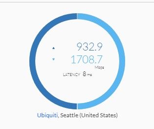

I think that I would arrange for your installer upgrade you to the NH20A. I assure you that you'll be much happier with it. On my 1.5Gbps connection I have a single connection speed at the router of over 1,700+ Mbps. Then that passes to my network via 10Gbps to NAS devices, and various media servers at 10Gbps and to most of the computers at 2.5Gbps. And best of all "Rock Solid"
as can be...
More fun to come as I believe that I'm on the path to the 2.5Gbps upgrade in a few days... That should be fun...Cheers
