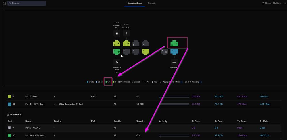

Telus => Pure Fibre => SFP+ => DreamMachine SE => SFP(10GB) => Enterprise 24 ports (2.5GB) => Cat 8 => 2.5G PC ethernet port.
I tested my PCs and data can be transmitted at 2.5GbE internally. I think the problem is from Telus's side. The reason is DreamMachine SE shows the SPF+ is 1GbE connection only. Please see the below screenshot.
Solutions would be to ask Telus to upgrade the cable or their side connection to 2.5 GbE or 10GbE to get 1.5 GB of download speed. Am I correct?

      Start with the Unifi OS version, all of my Unifi devices are up to date and my UDM SE is 3.0.13. Those devices are rebooted. UDM SE treats the WAN port (Port 11 SFP+ port) as 1 GbE port. So, the current version of Unifi OS won't fix the problem. I hope Unifi can fix this problem by releasing a new OS version. I want to upgrade to 2.5 GbE from Telus in the future.
      Since the UDM SE only accepts 1 GbE / 10GbE at port 11(SFP+) or 1GbE/2.5 GbE at Port 10 (RJ45), I think the best solution, for now, is to ask Telus to get the NH20A.
