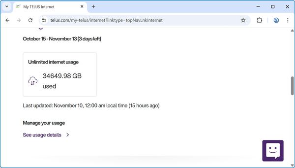

Massive reported network traffic on MyTelus?
I have fibre service with an NH20A in bridge mode to my own modem. I have nothing plugged into the other NH20A ports. I am seeing massive internet usage when I log into MyTelus, much higher than the activity reported by my router.
At first, I thought that my router had picked up a botnet, as it was an ASUS RT-AX88U Pro that was part of the vulnerability discussed at:
https://www.tomsguide.com/news/arcadyan-router-malware
... so I did the factory reset on my ASUS, and rebooted it daily, but the problem reappeared.
So recently, I got fed up and purchased an Ubiquity UCG Ultra to replace the ASUS.
I still see the massive data transfers on the Telus web site. For example, I show total usage so far today of 3924.27 GB on the telus web site, but only 14.8 GB for the last 24 hours on my Unify dashboard.
I'd like to update the firmware on the NH20A and maybe do a factory reset. Are there any risks to doing this? Will the admin password printed on the NH20A still be in effect?
Any other ideas on what could be causing this would be most welcome.

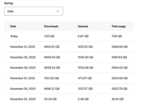

    It is on the My Telus Web page under usage details, a list, not a graph. I posted a picture, but it might not show because I'm new here. Not using peer-to-peer file sharing.

    I see it on My Telus Web, see attached image. I can only see the daily usage if I select the Past Cycle usage first. Not peer to peer or file sharing.
