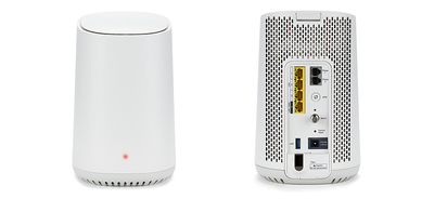

Network Access Hub is another name for the NH20T. The B21A is supposedly the Wifi 6E Boost unit and not the main router. The router that looks like the white cylinder would be the Home Wifi Hub but those are made by Arcadyan. The wifi hub / router looks like this:

Looks like the one in my basement that is larger is the Boost 6E, while the 2 other smaller ones are Boost 6E mini.
I was able to find the NH20T behind a cabinet on my main floor. Previously I thought there were only the 3 pods (1x 6e, 2x 6e minis).
This was confusing because the 6e is what's in my basement media cabinet, and it is being fed the main coaxial cable into it. The main modem was always in this media cabinet, as this is where all of the ethernet connections stem from. (Previously there was a T3200M that the technician removed.) This is why I expected this to have the admin password and be the main modem, but it seems that isn't the case.
Is this setup correct?I was able to connect to use the "connected devices" information to log into the main 6e, but there are no tabs to change the wifi name or password.
