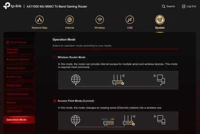

"I didn't see anything in the settings for the AX11000 that specifically spelled out that ability."
Yeah it does, I have the AX11000 in AP mode right now.
