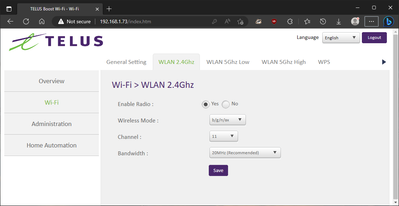

    I believe I have the same AP and it's connected to the router using the MOCA connection without issue. I also use the ethernet ports on the AP and they work fine but seem to 'hibernate' if not used for a while and take a bit of time (~30 seconds) to wake when the device connected to them is turned on.
    When I login to my AP and select the Wi-Fi tab on the left I can then select each band and specify a channel if desired:

    "I tried to adjust the Telus Access Point’s settings by logging into 182.168.1.254" 192.168.1.254 will log you into the router (you will need the credentials from the routing device to complete the login). Once there, you can find the IP address of the Wi-Fi 6 device (usually labeled Boost2.0 or similar) and connect using the credentials on the device. You can then seethe options of the Wi-Fi 6 device.
