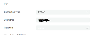

My current set-up uses an ER7206 TPLink Router through an SFP Wan port where the fiber cable is directly inserted into the modem, and then I have a PPPoE username and password which I get from Bell's website (it is the Bell "b1xxxx" internet login and a password which you set yourself through the bell's website.

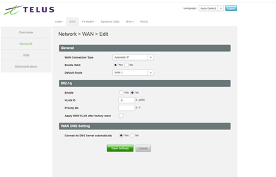

      Hey marting ,so my Telus service is still not setup (Scheduled for March 8, 2025) but I received the Modem and Router in the mail by Purolator toay. So I took the liberty of unpacking the unit and I accessed the NAH unit, by going to 192.168.1.254 and using the user and password on the cover of the NAH unit.
      When I went to the WAN settings it appears that the default is set to Automatic IP and not PPoE. I am not sure if the Technician actually configures this and changes it from Automatic IP to a PPoE configuration or is the Telus Server automatically configured to authenticate the NAH unit based on the MAC address of the NAH unit.
      These are the settings which are default preconfigured

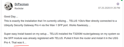

    I also see that DrPacman seems to be an expert at running his own equipment. DrPacman are you able to perhaps help me out?

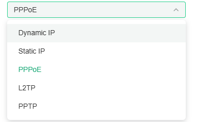

    If I am to pull the SFP from the Telus modem and install it into my SFP capable Modem form TP Link Omada that would be it? What type of connection would i be setting up if i am not using PPoE protocol "Dynamic IP"?
