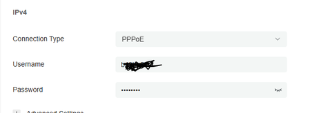

To answer your question, you can find the PPPoE credentials in the NAH interface. Go to 192.168.1.254 with the login "admin" and the password is written on the NAH under the cover.
Then under Network > WAN you should see the PPPoE connection settings and everything should be there. For the password, just change the input type from "password" to "text" using F12 for the Dev Tools
