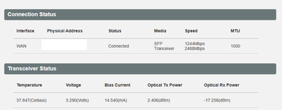

I am just wondering if anyone else has experienced this? According to Telus I have talked to before the provisioning is right, but it does seem like something else is wrong. This is my first time using Telus Fibre in a Condo and it seems to be on GPON (Max plan we have is the 1.5/940) I have changed DNS to Google's and Cloudflare's and it sometimes work and sometimes doesn't. I am currently running a new TP Link 2.5GB switch connected to the 10GB port on the NH20A (Both PCs have a 2.5GB Nic card), which came in after as Telus thought that was the main issue behind the random issues.

  • To add, this is what my ONT/modem is reporting for the Fibre connection
