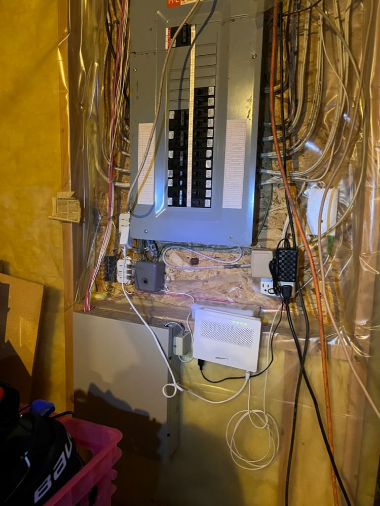

Yesterday I upgraded my Internet from Telus 75 to PureFibre Gigabit. I was noticing that I was only getting/maxing out at 100mbps through the T3200M (ethernet and wireless).

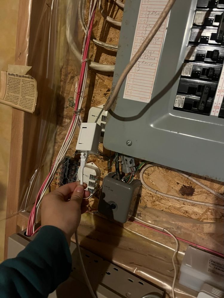

That's when I went down to the basement where my ONT was and connected an ethernet cable directly to it and got the Gigabit speeds. I noticed that the ethernet bridge between my T3200M and the Telus ONT has been substituted by, to me, what seems like an ethernet to DSL adapter? This would make sense why I am maxing out at 100mbps when connected to the T3200M.
I would assume I would need a technician to fix this?

    Can you show a picture of  ONT device ports?
    Can you show a picture of the T3200M modem/ router ports?
     ONT / ADSL adapter connects to your ADSL/VDSL port on your T3200M modem router

      Anonymous The ONT is not the issue. The tech that installed the fibre / ONT would have disconnected the DSL and phone lines. If the line was connected to the phone jacks on the T3200, there would be no internet.

    Which port on the T3200 is that adapter connected to? Is there another adapter at the T3200 also? How far away is the T3200 located?

      It is connected to the ethernet WAN port on the T3200.
      The T3200 is located upstairs and a little bit away from the ONT, so it is not directly underneath the ONT.
      So it goes. ONT out on LAN1 via ethernet to the ethernet to DSL switch then upstairs theres a ethernet wall outlet that is connected to the T3200.
      I assume it is this adapter that is making my T3200 not give Gigabit speeds.
      • Nighthawk's avatar
        Nighthawk
        How recently was the fibre installed? If fairly recently and if you have the installers card, maybe reach out to them. If not, I'd recommend reaching out to support to get a tech out to ensure you're able to get gigabit to the T3200. I've never seen them use that type of adapter before. The big issue will be if the line leaving the adapter and going upstairs only has 2 pairs of wires in it like a regular phone cord. If it does then it's physically incapable of delivering gigabit speed. Gigabit needs all 4 wire pairs on the ethernet cable.
