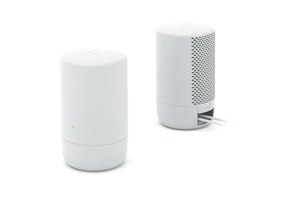

      I have the T3200M with the same version of firmware as yours. I also have the Boost Wi-Fi 6 access point which is likely what you got.
      I've disabled Wi-Fi on the T3200M and just use the Boost (connected to the T3200M with MOCA). This works really well and I see pings in the high 'teens.

        If you are using the T3200M as a router/switch and connecting a separate WiFi radio then it's probably fine for that.  However, I am of the opinion the built in WiFi radio in the T3200M is too outdated and inadequate to properly handle multiple HDTV streaming over WiFi.
        The android TV boxes we have are called TelusTV-21T which is supposedly the newest stuff.  My suggestion to anyone that has or is getting those boxes and connecting wirelessly is to insist that Telus send them the cylindrical Boost WiFi 6 radio pictured above.  If they won't then I suggest buying your own WiFi 6 Radio.  Any inexpensive WiFi 6 router from BestBuy/Amazon should work fine.  You would just set it up to work as a switch and bypass all the routing functions.  If you already have a T3200M router/switch then there is no need to replace that as long you do not use the built in WiFi for streaming to multiple TelusTV boxes.  Streaming to one box wirelessly is fine but it seems to struggle doing more than that unless you enable WMM, which then increases your ping times.
