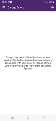

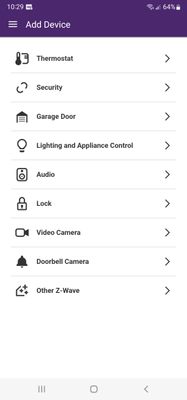

First issue I noticed was both the app and the website don't allow you to specify anything at all in the garage door menu.  When you select  >Add device>Garage Door, they both have no choices in that menu and speed you through it automatically selecting "Linear Z-Wave Garage Controller". Needless to say the setup process does not work as the garage door opener is a WiFi device and not Z-Wave. Additionally the selection to add "other" at the bottom of the list has now also been changed to "Other z-wave device", also not working.
The Telus support article https://www.telus.com/en/support/article/add-chamberlain-liftmaster-myq-smart-garage-hub-821lmb-to-your-home tells the user to select the correct device under "Garage Door" to proceed. How do you install this opener when there are no options to select anything in that list and automatically forces the selection of the Linear z-wave controller..

      With both devices the current port of the app only allows you to select the specific device name from the preset list, if its not in the list the only "scan for all" option at the end of the page ONLY lets you add Z-Wave devices in Telus's ported version, not WiFi standard Devices.

      As mentioned earlier when you click on "garage door" only the "liner z-wave" door opener is on the list and it is pre selected for you with no option to change it.

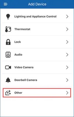

      In the ADT setup guide (linked above) there is a pull down selection in ADT's version of the app allowing you to select the correct opener..  Note the add device option only specifies z-wave now..
      Telus port of app - Specifies only Z-wave addition
      Telus's Port of the alarm.com app - Note Add Device limited to Z-Wave only
       Original Alarm.com app.
