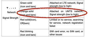

Hi there forums, I have a Telus Wireless Home Phone using the ZTE723CA model device. While it works alright - I noticed that it no longer shows a green bar for the service signal, but an orange o...

If anyone has similar issues - what I've done is ordered a new service line which comes with the exact same ZTE WF723. Same price @ $10/month.
This new line one works using VoLTE, and doesn't go orange and drop to 3G on calls.
To test, I swapped the SIM's between the two ZTE WF723's - and voilĂ - the new SIM is properly provisioned for VoLTE and works using the LTE network on both ZTE723 devices. Fancy that?
