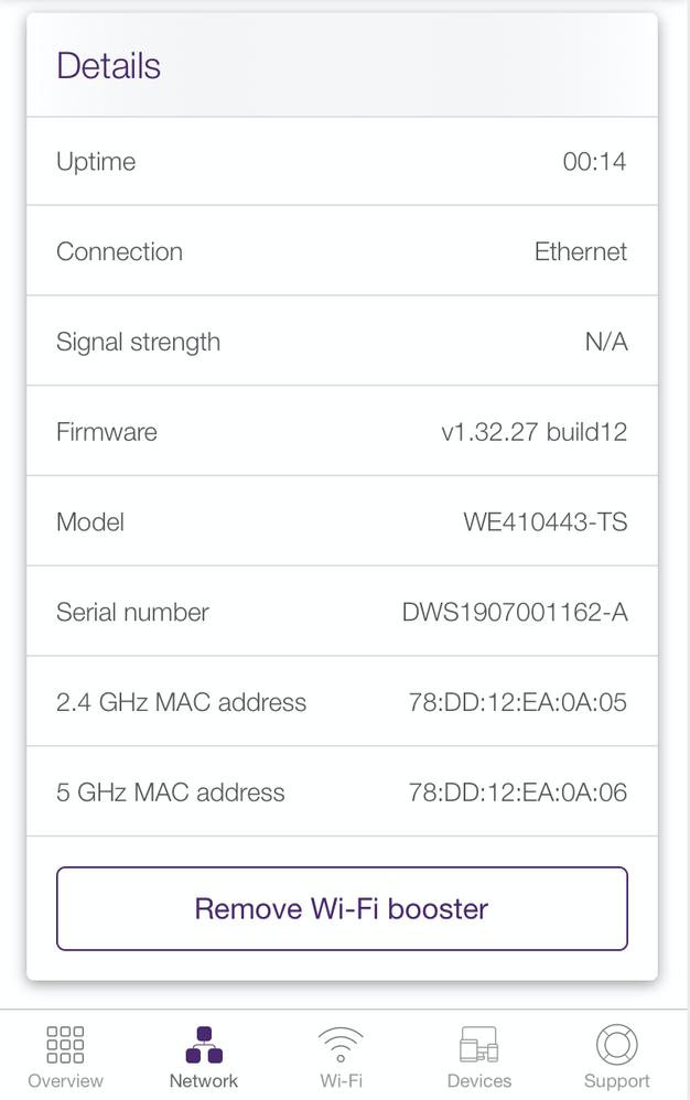

Powderjockey
6 years agoAdvocate
How do you find out what firmware the Boosts are running?
