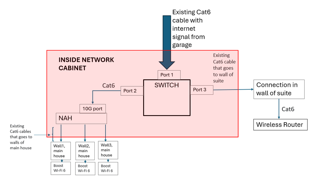

If you only have Fibre 250, then any decent gigabit ethernet switch will work. You can get a lower end 5 port gigabit switch for about $15. And a better one for about $22. You'll just need a couple Cat6 ethernet cables to connect everything. Keep in mind anything connected to the switch has a direct outside connection and you'll only be able to connect two devices as residential accounts are only offered 2 IP addresses. Doing this means you won't have to fiddle with bridge mode. The guest network will have an entirely separate connection on the separate router you connect to the switch for it.
Essentially you take the ethernet connection that runs from the garage and plug the end of it from the NAH 10G port into one of the ports on the gigabit switch. Run an ethernet cable between the switch and the NAH 10G port. Run another cable from the switch to the separate router to be used for the guest wifi network. Your original Telus router will work fine and should not need any configuration changes.

I have to say I didn't find this clarity when I was searching online - I hope this post can be useful for others! With that in mind, I've put a diagram of what you have suggested at the end of this message and summarised the instructions. I'm sure I'm not the only one with this query in mind, and with their internet coming into their 10G port!
Does it look about right?

STEPS AS I UNDERSTAND THEM:
-Unplug the Cat6 cable from the 10G port onNAH (that cable brings the internet into the house) and plug instead into the Switch.
-Plug a new Cat 6 cable from switch to the now vacant 10G port [House internet is now up and running]
- Plug existing Cat6 cable (that goes to the wall of the suite) into the switch
-Put wireless Router in suite, attaching to the wall connection that is now attached to the switch [Separate guest network now up and running].

2 years agoQuery 1: You said "keep in mind anything connected to the switch has a direct outside connection". I wondered if there was some risk/issue to worry about here that you were thinking of?
Only connect a router to the switch. You don't want individual devices connected to it for security reasons. Additionally since your connection is only alotted 2 IP addresses, if you start connecting additional devices, they will fail to connect. Bridging would still use a second IP but it wouldn't allow additional ones unless you change the router or device connected to the bridged port.
Query 2: Is there a "risk" to having the walled connection in the suite "live" running directly to the switch?
I'd stick to just offering them wifi. You can configure many routers to only allow access to log in to them over ethernet connections. That way if the users are on wifi, they won't be able to try log in to the router and mess with things. There are some third party routers that you can get that specifically have settings for guest suites / networks. If you did put an ethernet jack into the rental space, you could still have the router outside of the rental space and just have the ethernet jack connected to it instead. Direct physical access to the router would be a bad thing. I would not put the router inside the rental space.
Query 3: Similarly, if the new wireless router itself is in the suite, is this more risky as guests have physical access? I'm not sure I have a choice, but if there was a wall connection in the main house close to the suite that I could use, instead of placing the wireless router directly in the suite, is that something to consider? (this way they cannot plug directly into the router and mess with settings for e.g.) Or this this me just being over-the-top?
Query 4: Would you be able to explain in simple terms why the switch might be more secure than the bridging?
Because the switch would be two physically separated devices / networks. People have had isssues with bridging in the past under certain conditions so a switch and separate router would likely minimize issues. You could always start with bridging to see if you have any issues. If you don't, then you could leave it as is. If you do, then get a switch and go that direction instead.
Query 5: What would happen if I had faster internet that Fibre 250? (I have Fibre 250, but others might have faster, and I am also curious - as I say this is super interesting!)
With a gigabit switch before the Telus router, the max speed you could get is gigabit. If you ever wanted faster than gigabit, then you'd have to look at a 2.5gbit or 10gbit switch, which are more expensive. Though the more likely scenario is the NAH with the 10G port would likely have to move to where the fibre itself is since that's the device used for connections faster than gigabit. Unless Telus has a newer ONT capable of faster. The ONT I have only supports gigabit. The ONT is the device that converts fibre to ethernet.

I got it done! Following your advice I now have two separate networks.
My check that it works:
- on my home network my iphone can cast to my TV. On the new guest suite network I cannot see the TV. Excellent!
- Both networks access internet.
