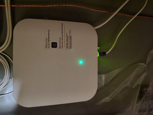

The first point that I would like to make is, it’s no longer going to be possible to remove TELUS supplied hardware from your network configuration. You have two options. First, have the ONT Router/Firewall feed the connection to your system as was originally anticipated. Or, place the device in bridged mode and allow your aftermarket Router/Firewall device to feed your system.
The device known as the “NAH” (Network Access Hub) more technically known as the Arcadyan NH20A, or the Technicolor FXA5000 virtually the same device for all examples here. As well a device known as the Nokia XS-250X-A however, that is for very specific installations, and out of the scope of this discussion.

If you plan on continuing to utilize the TELUS NAH ONT Router/Firewall you are able to plug your devices into the 10Gbp/s port (Purple RJ45 port on right side) on that device. I’m sure people will connect to a dedicated 10Gbp/s switch for the ability to connect multiple devices within your own network environment. As long as you connect devices with a minimum connection speed of 5Gbp/s you should be fine to go.
Again, if you plan on utilizing your own aftermarket firewall/router, you can put the NAH into bridged mode and pass a TELUS WAN IP address directly to your aftermarket Router/Firewall.

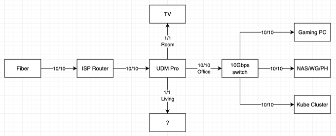

  • I know its an old tread.... but now... can you just disconnect the XGPON from the TELUS NAH and connect it directly to the UDM (New Gateway)

      ChristoGM​ Unfortunately no.  If you are on a XGS-PON service package, authentication is done with both the SFP and the NAH as a combination against TELUS' network (PPPoE).  There are ways to eliminate the NAH altogether but that would require purchasing a customizable WAS-110 SFP+ with custom firmware on it.  Long and short of it is, you clone the NAH into the WAS-110 so it verifies itself on the TELUS core network and appears as it would have when TELUS initially installed the service.  I think there are marginal performance benefits bypassing the TELUS NAH switch.  Going the WAS-110 route is a bit cumbersome and has a cost.  Most people would just configure the NAH in bridge mode, then on to their own equipment and be done with it.
