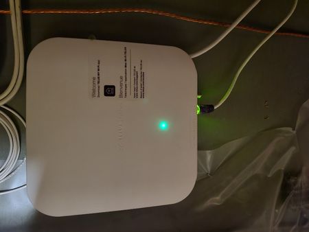

ChristoGM
1 year agoNeighbour
I know its an old tread.... but now... can you just disconnect the XGPON from the TELUS NAH and connect it directly to the UDM (New Gateway)
StokieDood
9 months agoFriendly Neighbour
ChristoGM Unfortunately no. If you are on a XGS-PON service package, authentication is done with both the SFP and the NAH as a combination against TELUS' network (PPPoE). There are ways to eliminate the NAH altogether but that would require purchasing a customizable WAS-110 SFP+ with custom firmware on it. Long and short of it is, you clone the NAH into the WAS-110 so it verifies itself on the TELUS core network and appears as it would have when TELUS initially installed the service. I think there are marginal performance benefits bypassing the TELUS NAH switch. Going the WAS-110 route is a bit cumbersome and has a cost. Most people would just configure the NAH in bridge mode, then on to their own equipment and be done with it.
