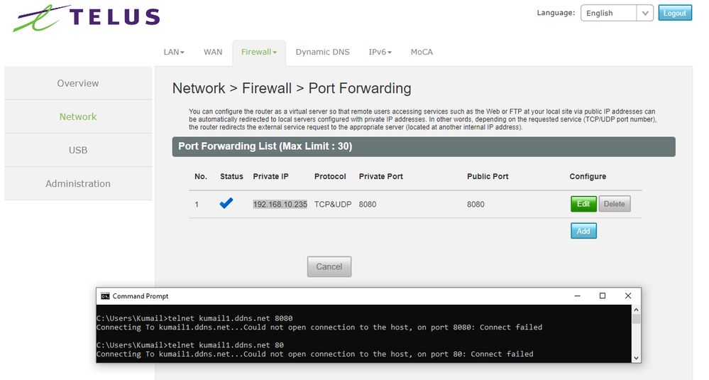

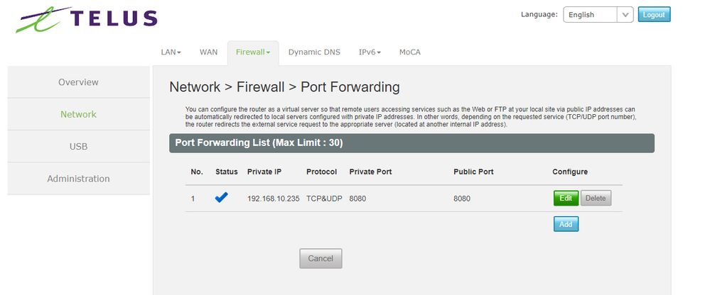

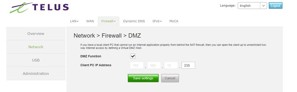

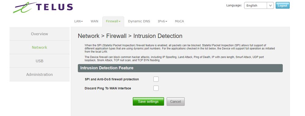

Cannot Access network from outside, unable to do port forwording

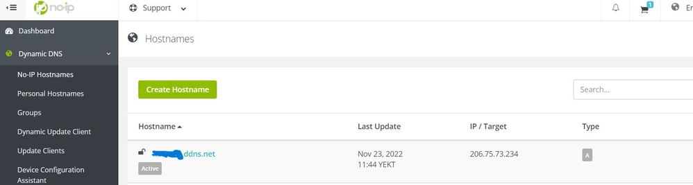

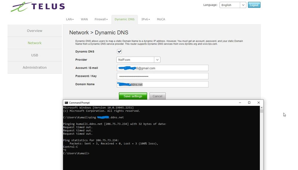

Hi, I recently got Telus 1gig pure fiber net, now when I am trying to access the network or if I am trying to make any gaming server, I am unable to do that because I think Telus has blocked each and everything from outside, I have also a system which I need to access from outside network through Remote Desktop Connection(RDP), I have tried each and everything, I have turned off my router firewall as well as I have disabled intrusion detection(DDOS Atack and Ping from outside) still I am even unable to ping my current public IP from the outside network, also I have NOIP ddns which I have entered in my router but still I am unable to do port forwarding or even ping my router from outside.
Is there anyone else who faced a similar problem, and if yes then what's the solution?
Just one thing which I have not tried yet is Bridge mode because currently, I do not have any second router which I can connect to the Telus modem for bridging.
My telus modem model is : Arcadyan NH20A
I am also attaching some pictures for clarification2022-11-22_22-48-54.jpg2022-11-22_22-49-27.jpg2022-11-22_22-50-11.jpg2022-11-22_22-50-30.jpg2022-11-22_22-50-50.jpg2022-11-22_22-51-16.jpg2022-11-22_22-51-33.jpg2022-11-22_22-56-50.jpgScreenshot 2022-11-23 115255.jpgtelus1.JPG.

Port 21 is blocked. See this:
https://www.telus.com/en/bc/business/support/article/telus-hsia-security-measures-policy
Port 8080 should be open at the router but your device (Windows?) may be blocking it.
Where is the device that you are doing the Telnet to 8080 form? If it's connected inside your LAN then it's not going to work. You need to be outside your LAN to be able to access your WAN IP.

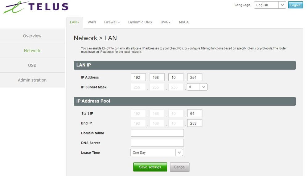

I assume you have assigned 192.168.10.235 to your server and not using DHCP?

yes I have windows ten server and I have just made IIS with port 8080 to check whether it is connecting from outside the network or not, then I switched to the mobile hotspot which is shaw network, and from that network, I was unable to telnet or ping that IIS serving which has local static IP: 192.168.10.235 and port forwarding on the main router modem.

Personally I have not had any problems like this at all. However looking at the images you posted I see you are not behind a Carrier-grade NAT address. So that is a good start for you.
