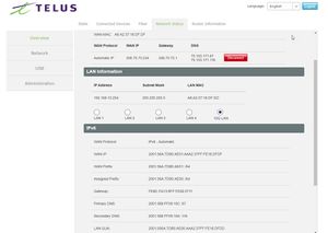

Cannot Access network from outside, unable to do port forwording
Hi, I recently got Telus 1gig pure fiber net, now when I am trying to access the network or if I am trying to make any gaming server, I am unable to do that because I think Telus has blocked each and...

yes I have windows ten server and I have just made IIS with port 8080 to check whether it is connecting from outside the network or not, then I switched to the mobile hotspot which is shaw network, and from that network, I was unable to telnet or ping that IIS serving which has local static IP: 192.168.10.235 and port forwarding on the main router modem.

By the way, I connected mobile hotspot while I was pinging from an external network however the Telus page which is shown in the picture was previously loaded 😁
