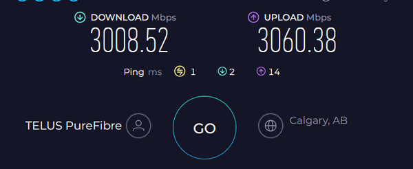

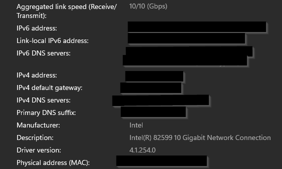

I have UCG-Fiber connected to the TELUS ONT (Bridge mode) via CAT6. From my UCG-Fiber, I'm connected via DAC to a 10Gbe X520-DA1 NIC.
First test:

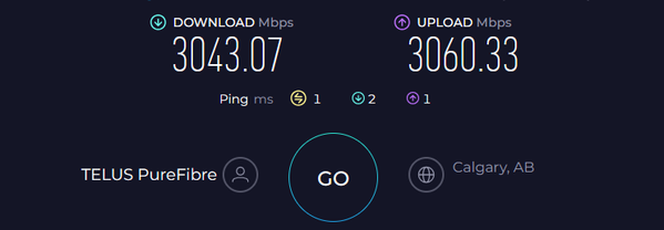

Second test (Directly connected to Telus ONT via CAT6 to the X520-DA1, with a SFP+ RJ45 adapter).
