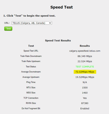

I just did a speed test from my T3200M. This was done while someone was doing a video call at the same time. I normally get over 80 Mbps if my network is idle.
- xrayHero
How many devices do you have in total on your network? My experience with the T3200M is that it struggles when there are more than 20 or 25 devices. That's one of the reasons I run an Asus router inside my network. I currently have anywhere from 45 to 55 devices connected at any given time. I'm also on Internet 75 and I work from home. No issues at all.
As for the speed you are getting log on to the T3200M and run the speed test from there. It's under Advanced Setup/Modem Utilities. That will eliminate any WiFi issues you have from the equation. Do it when your network is not busy to get an idea of upper limit for speed.

Ran the speed test from the embedded web server and it reports average down as 37Mbps and 9 up.
