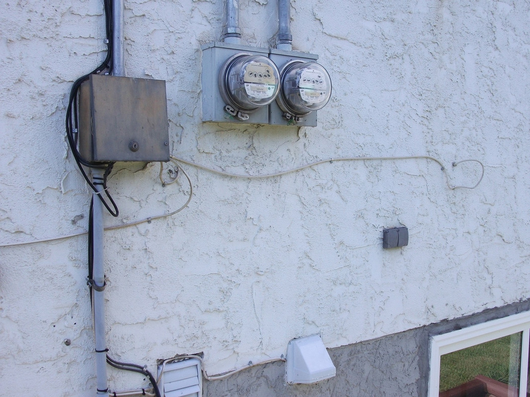

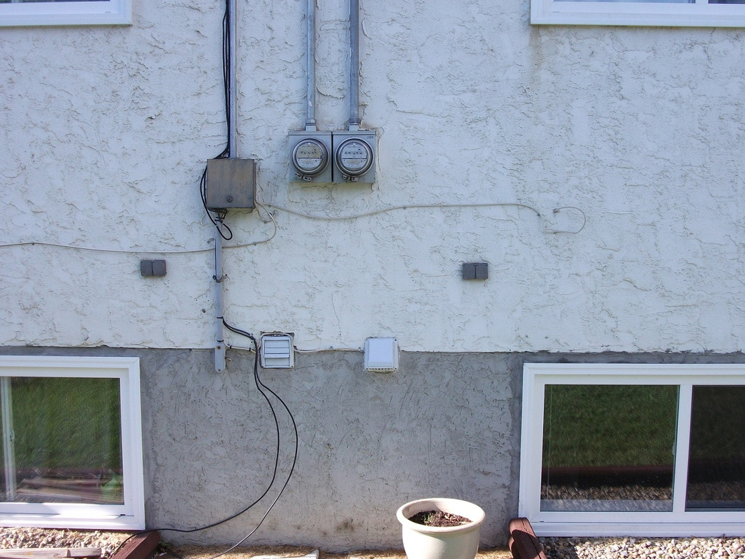

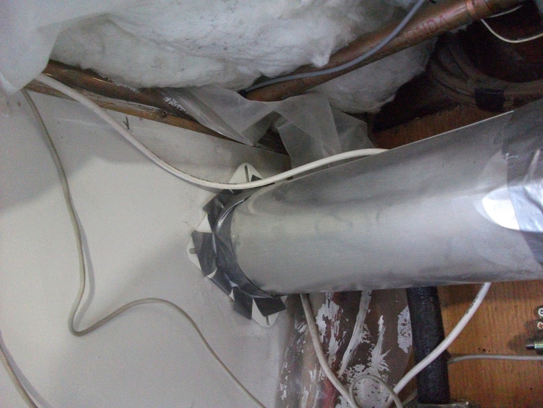

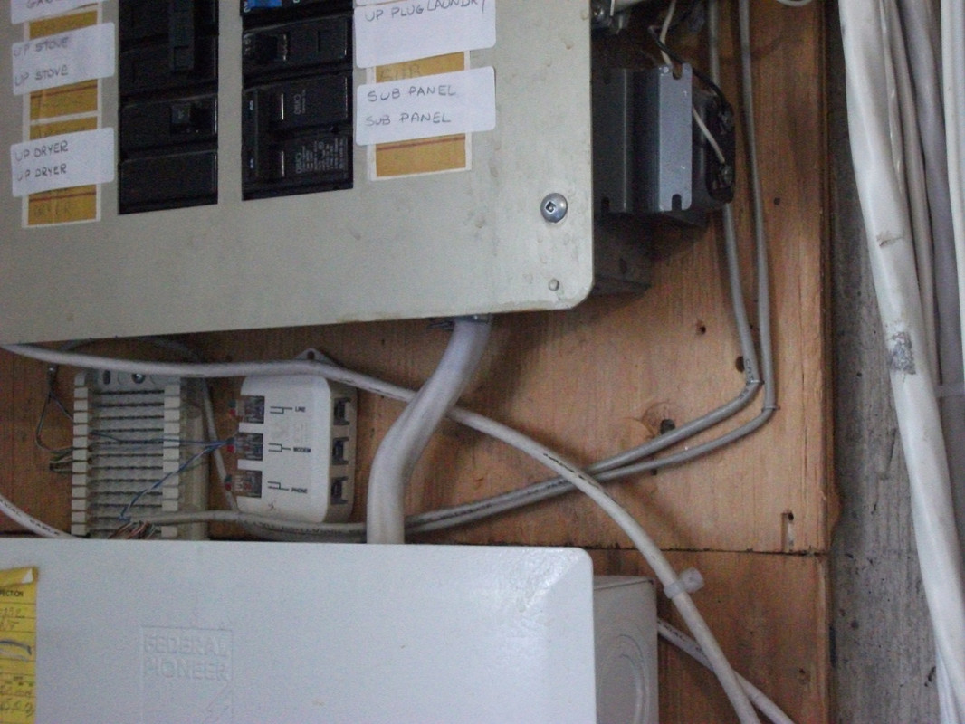

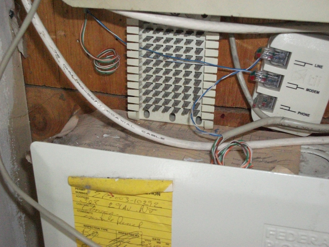

I have VDSL internet on a 50 Mbps plan and I'm only getting 38 Mbps. After checking with my ISP and doing all the testing of my line and modem over the course of a week, I'm pretty convinced my slow ...
Phil_Harmonic
6 years agoOrganizer
I've already been through the whole complaint and testing process with my ISP, that's why I am on here. My ISP said there is always some throughput loss at the modem. But there shouldn't be a whole 17 Mbps loss on a relatively low speed plan, especially since the tech was getting 56 at the demarc. I'm not really expecting the exact full 50 speed on my plan. But 45-48 would be nice, given that I always got 25 Mbps on my 25 plan.
This is why I came here for wiring advice, since I am pretty sure it's the wiring of my suite.
I don't know who is responsible for which wiring where, and if Telus can do inside wiring, or only the demarc.

Telus owns the NIB/Demarc box so electricians likely won't touch it. Do you have just the NIB/Demarc outside the house or is there a box inside as well?
Nearly all houses have a line coming in and there will be somewhere inside the house where that line is split to the other jacks. Some houses are wired in daisy chain style where the line runs from one jack to the next. Others can have independent runs to each of the jacks. Some are a mix of the two.
Do you know for certain that the wire from the NIB/Demarc outside runs directly to that specific jack?
What is the Obihai ATA device connected to?
If no splitter was installed, definitely try moving the modem to another phone jack to see what happens.
- Phil_Harmonic6 years agoOrganizer
Ok, but if you can't change or alter the wiring inside the house without disconnecting the wire at the NIB box (which is locked, and I presume only Telus is permitted to unlock it?), then do I call both Telus and an electrician?
