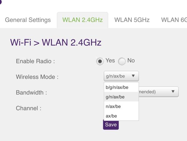

Step 2: Lower the 2.4GHz Mode (Fixing the Wi-Fi 7/6 Compatibility)
Wi-Fi 7 uses legacy compatibility modes, but sometimes the "Preamble" or AX/BE features confuse old 802.11b/g/n chips found inside older smart cameras.Inside the Wi-Fi 7 advanced settings GUI, go to the Wireless / Advanced settings for the 2.4GHz band specifically.
Look for Wireless Mode or 802.11 Mode.
If it is set to Auto (Ax/Be/Native), change it to Legacy, Mixed Mode, or 802.11g/n Compatibility Mode. This forces the Wi-Fi 7 booster to broadcast a simplified beacon that your old Mi camera can actually read.
- Mojodaddy3 months agoFriendly Neighbour
These are the only options I have here
