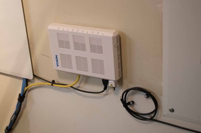

    If you have the SFP plugged directly into the T3200, then you do NOT have an ONT. All the ONT does is take the fibre / SFP+ and convert it to ethernet. The ethernet would then be connected from the ONT to the WAN/Internet port on the back of the T3200. If you actually had an ONT, all you'd need to do is connect the ethernet from it directly to your Asus router. You wouldn't need one with a SFP port in that instance.
    One thing to realize is that if you are using a third party router with the SFP connected directly to it, Telus won't be able to troubleshoot issues that you may encounter. Any issues that arise from a third party router could result in a service charge for a tech coming out if the issue is determined to be with your equipment.
    ONTs look like this:
