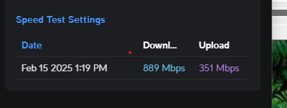

How to get the max speed with unifi
Hi, I have a new Unifi gateway dream machine pro max. When the technician installed the NH20 he specifically gave me an ONT that allow me to use the ONT serial number to register with Telus fiber...
