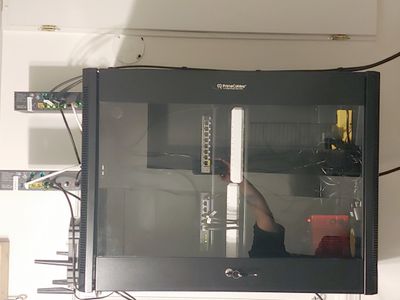

        20220419_133555.jpg"The problem that I have is that I want to get rid of the Telus router and use my own devices.  I can't figure out how to get the TVs and PVR to work without the Telus router."
        I've been doing this now myself for weeks. I too have been using a unmanaged switch for now, but want to change to using a managed switch, with VLAN capability, for other purposes, I just haven't set the managed switch up for the job.
        You can get routers with IPTV/multimedia capability, you just have to set them up for Telus. It's been done. You just have to find one that is known to work well. Some people have tried this with cheaper/lesser capable routers and have had them die, due to stress. If I were you I'd keep the "Free" Telus router just for this purpose, as it is very good at what it does. What are your needs that you want to get rid of the Telus router?
        I, personally, love the use of two physically separate networks for just the redundant nature of them, firstly. Everything else about it, is gravy.
        One Nokia G240G-A ONT is connected, the other is just a spare, left behind by Telus, when we hade two fully separate 1Gb fiber installed connection. I bought a cheap T3200M off Craig's for $30, just because I'm so used to working on it, it was an easy fit as a dual network. My plans are to now expand one network at a time, without disruption to the other.
        I have a WRT32 sitting up there, with DD-WRT on it, I also have a AX11000 WiFi router off of one of the T3200M acting in AP mode. The AX11000 is fully capable of doing IPTV, but I have now desire to use it as such. Too expensive to waste on TV duty.
