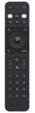

Fail to Pair Telus Remote with Roku Plus Series TV
When pairing the "Telus TV Remote" with a Roku Plus Series  TV, the mute and volume buttons work, but when I accept the code (any of 3) and continue (complete), then the buttons no longer work. Oddly the Power button does work.
Process:
  • Settings > Device settings > Remotes & Accessories > Program Remote with TV
  • Search for Roku TV, and select
  • Press Mute and Volume up/Down (they work)
  • Select "Yes, Finish" (volume still works)
  • Select "Continue" (now back to Remotes & Accessories)
  • Now the Mute and Volume buttons no longer work. Only the Power button works.
It is as if the remote failed to store (save) the code.
The remote:
The Roku TV: Model 55R6CX; Hardware ID P403X

    Option 2, un-pairing and re-pairing the Telus remote worked. The volume controls on the Telus remote now work with the Roku TV. I used "Roku TV" code 1.
    However, other functions (like left/right/up/down/ok) do not work, so I still have to use both remotes most.
    I did not try option 1, as I do not want 1-touch play enabled (but System audio control was already enabled, for my sound bar).
    • TELUS_Support's avatar
      TELUS_Support
      Glad un-pairing and re-pairing fixed the volume :)
      Just a heads-up the TELUS remote only syncs power, volume, and mute for TVs. Navigation buttons are permanently mapped to the TELUS box, so they won't control your Roku TV menus.
