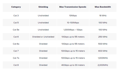

  • I think it depends on the maximum transmission speed and distance that you are planning for. See this table.

      RonAKA  You are correct there is good better best. Your table will not show up on this site. Thats why i say talk to a good computer installer . Maybe plan for the speeds 5 years down the road.

        Strange. Why would the image not show up? I can see it.
