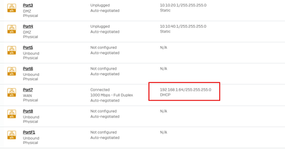

Static IPs configured on the WAN side of the NAH is what I am trying to avoid.
The very fact that NAH has 2 sides: WAN and LAN means that is acts as a router/NAT.
I need the static IPs configured on my own business firewall, that takes on the entire role of the router/VPN gateway/firewall. While the NAH in front of it must act as a "dumb" pass through converter from fiber to copper (modem).

And yet, here we are. I am 300km away from the customer site to confirm visually the device that was installed. The on-site tech from Telus said he wasn't sure. The phone support said it was Arcadyan based on the job order. The firewall does not receive internets if I configure WAN with static IP addresses. But if I put it in DHCP mode, it gets a private 192 address and the internet works. Telus support says that's how NAH should be configured if I want to use static IPs, which DOES NOT MAKE ANY SENSE.
