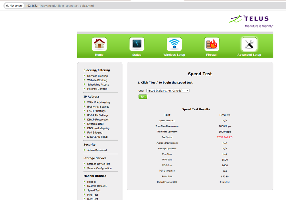

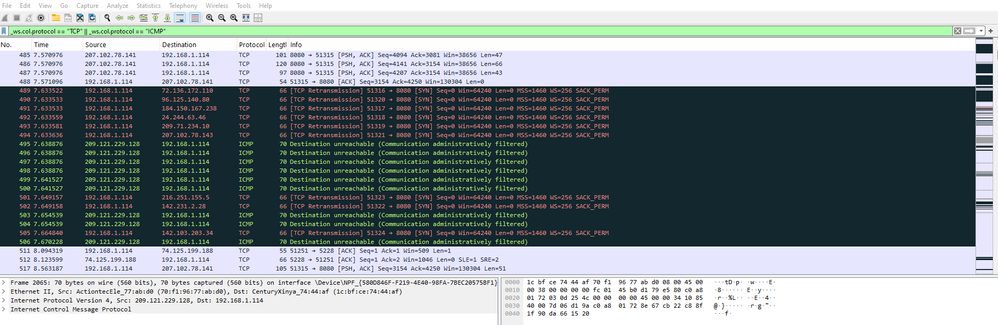

I’ve been experiencing intermittent HTTP/HTTPS connectivity issues for about a month, primarily in the late evenings. Approximately 80-100% of TCP connections (ports 80 and 443) fail during these periods, rendering the internet nearly unusable. Wireshark captures show a Telus-owned IP (209.121.229.0 or 209.121.229.128) responding with ICMP "Destination Unreachable (Communication Administratively Filtered)" errors. Additionally, the T3200 router’s built-in speed test (using Telus servers) fails during these times, ruling out customer-owned equipment as the cause.
Interestingly, using a WireGuard VPN restores full connectivity when the VPN successfully connects, suggesting a misconfiguration in Telus’s network, possibly on a load-balanced server that rejects connections during high-traffic periods. Another Telus user reported similar issues recently: forum.telus.com/t5/Internet-Home-Phone/internet-fail-suddenly-and-sporadically/td-p/167582.

Ping, nslookup, and traceroute work fine, but TCP connections fail.
Attached is a Wireshark capture showing TCP and ICMP traffic during a failure, highlighting the ICMP errors from 209.121.229.x.  and a screenshot of the T3200 router's internal speedtest failing.

    This is the reply I received from a senior networking employee at Telus:
    "Our current configuration limits CGN to up to 512 simultaneous ports for translation through our NAT infrastructure. It seems you are among a very small number of customers that are likely hitting that threshold. I would like to get you support to move your service to Public IP. You can call in to support and ask to be moved from CGNAT to Public IP."
    Normally, this limit would not affect most customers, but I had an Android phone and an iPad that were each making 150 outgoing TCP connections, leaving the rest of the household with a very diminished connection pool. I was unable to determine what application on these devices was consuming so many TCP connections.
    My interim solution was to use an open-source router that was capable of redirecting all network traffic through a VPN service. This resulted in speed limitations and increased ping times, but did restore web browsing ability. My final solution was to fight the uphill battle with Telus and have their support team change my account from CG-NAT to a Public IP. I would warn others that trying to have these changes made by Telus support is excruciating, and may take many, many calls to get it accomplished.
