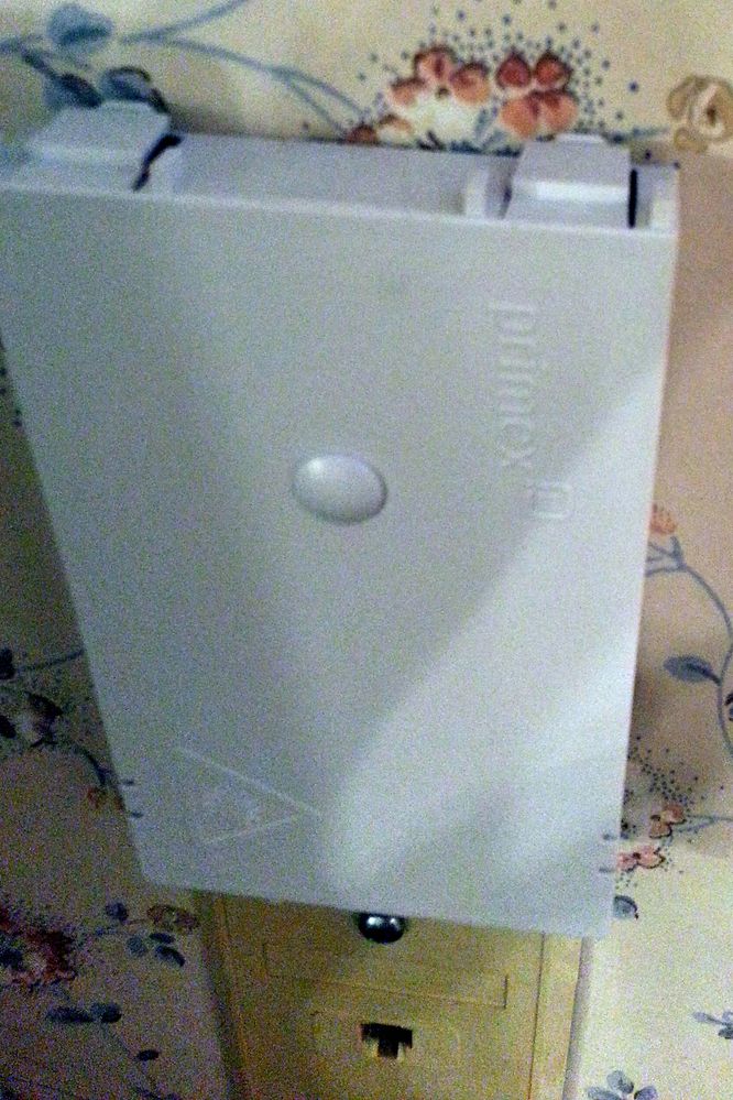

I would appreciate advice. We are renovating a condo in downtown Vancouver that had fibre installed a couple of years ago. The condo was built in 1982, and has a suspended ceiling with 15 inches of space above.
Coaxial cable runs from the entry point to the living room, and the bedroom. Attached are two photos of the entry point.

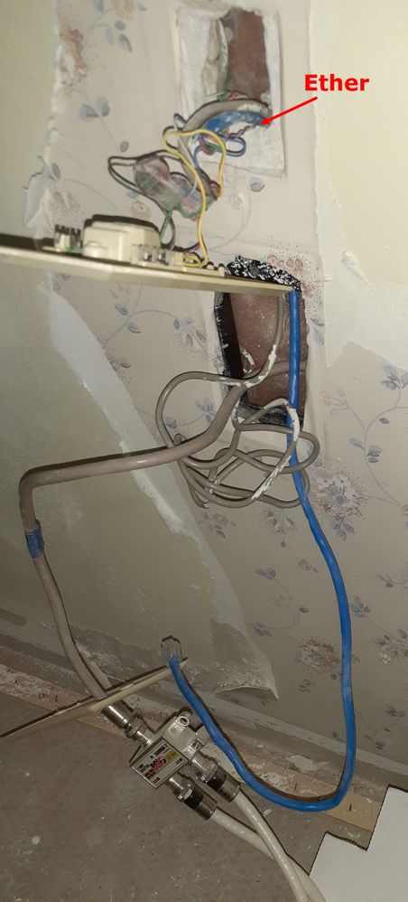

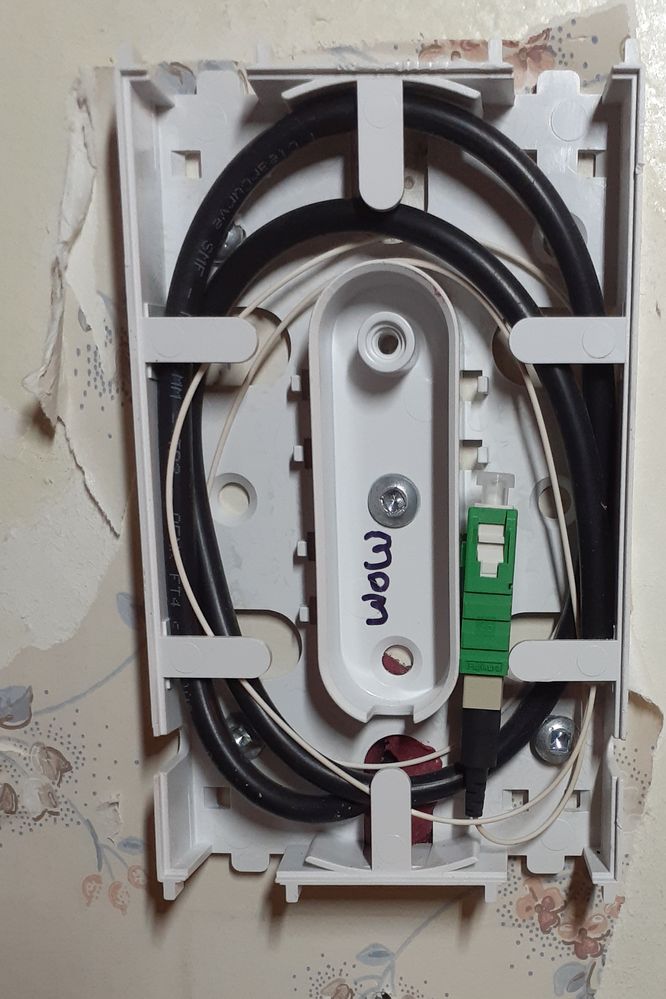

Here is the inside. Also the second picture shows the Ethernet cable.... it hooks through the wall then is deconstructed and hooks into the phone jack craziness ???
Any help appreciated!
- polecatAll-Star
Now i see -- fibre panel is good the rest is junk . not enough wires in tel cable to do internet from ont. The fibre will hook to the ont ( Needs 120 volt ) run cate 5 above the tbar to your locations. You can have your router modem with wifi fed with the cate5. Possible feed the cate5 from inside the wall to above the tbar ceiling so it is hidden. I would get an electrician to do this if you don't know how. Being a condo your wifi coverage should be good even with some concrete walls . The tv's can use the wifi to feed them. Good luck Polecat
- polecatAll-Star
No pictures yet---- My take of this--- internet pre fibre by cable company to modem cate 5 from modem hooked to tel cable to go rooms with computor. Tel wire has enough wires to hook up to for internet. Not the best but a lot of people have made use of the tel wires to get to their equipment without major opening of walls etc.

""Can you open up the white box and take a picture of the inside?""
I will try to open everything up today to get a photo.

I can see your pictures now.
Consider installing proper wall jacks like this:
https://www.amazon.ca/dp/B07TYY47QW/ref=sspa_dk_detail_0Does the existing Ethernet cable connect to the white box from inside the wall or is there another room behind that wall?
Can you open up the white box and take a picture of the inside? - xrayHero
