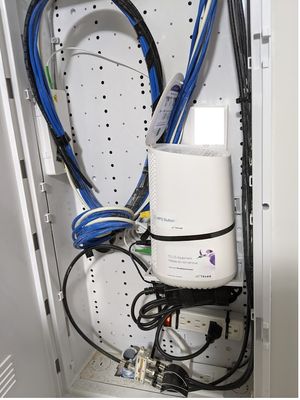

I purchased a new-built townhome which is Telus pure fibre ready (quick connect). I called and activated my service. But only the wifi is working since the ethernet cables are missing connecter head...

4 years agoNow that I can see joyita07 's photo, I have a panel like that in my place but the builder / electrician installed a patch panel in there and terminated the ethernet cables to that. The panel linked isn't the exact one but it's very similar. I just had to run a few short ethernet cables from my Telus router to that panel.
