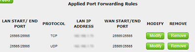

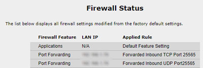

    If it helps at all to see what I've done, I can post a couple screenshots:
    Here's how I've got port forwarding set up under Firewall>Port Forwarding, where LAN IP Address = the internal IP of the maching running my server.
    Here's my firwall status showing that everyting appears to be hunky dory?

      Your images will only show up after a Mod reviews them.
