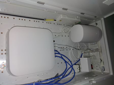

New fiber install. Can't connect 2.4Ghz smart bulbs to network.
We just had Telus PureFibre gigabit internet installed. The ethernet and wifi seem to work fine with our laptops and cellphones, but I cannot get any of my smart lights to work. Also, if I try to log...
