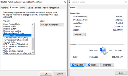

Network adapter stuck at 100mbps
Just got Telus internet setup, paying for 940mbps. Running cat6 cables from telus router to the wall jack, then cat5e from the wall into a gb pcie card in my computer. My internet speed has been limi...

Was as simple as changing the wall jack :^) thanks for the help
- xray4 years agoHero
Gb speed requires all 8 wires, 100 Mb only requires 4 wires. An improperly wired jack with less than 8 wires connected properly may fall back to 100 Mb if the right 4 wires happened to be connected correctly.
