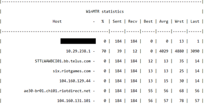

- Online games experience packet loss and high ping at 2nd node (I'll attach a WINMTR screenshot with the tracert logs)
Sometimes power cycling the router/modem will resolve the issues but usually It'll naturally come back after a few hours. Almost all devices except phones are connected via Ethernet in our house, and previous to this issue everything was running extremely smooth. I've spoken to an internet specialist for one of the online games I play and their take on the issue is that it is an ISP problem due to that first node. Ive been keeping an eye on that node for the past week and things just get worse with the packet loss and latency. I've optimized my firewall, DNS and other settings but nothing really works.

If the loss / high latency at the 2nd hop was fully affecting the connection, all the following nodes should have similar results. There's likely something else at play here. When I try MTR to 10.29.238.1 I see no packet loss or anything similar to what you see. For the time being I would recommend ignoring the second hop.

My MTR results to one of Riot Games' NA servers look similar aside from the 2nd hop.
|------------------------------------------------------------------------------------------| | WinMTR statistics | | Host - % | Sent | Recv | Best | Avrg | Wrst | Last | |------------------------------------------------|------|------|------|------|------|------| | 192.168.1.254 - 0 | 40 | 40 | 0 | 0 | 1 | 0 | | 10.145.148.1 - 0 | 40 | 40 | 4 | 4 | 5 | 4 | | sttlwawbci01.bb.telus.com - 0 | 40 | 40 | 28 | 28 | 30 | 29 | | six.riotgames.com - 0 | 40 | 40 | 25 | 25 | 35 | 26 | | 104.160.129.35 - 0 | 40 | 40 | 28 | 28 | 29 | 28 | | 104.160.131.3 - 0 | 40 | 40 | 59 | 59 | 61 | 59 | |________________________________________________|______|______|______|______|______|______|

- In-game my ping has not changed - its always been a smooth 52-60ms. I feel like I'm experiencing about 500-1500ms of ping at times, but my in game numbers show 200+fps and relatively stable ping (52-60ms) Another note is that the game's client is extremely laggy as well, I'll click a button 2-3 times before it registers (riot support told me this was due to the packet loss and node problems)
