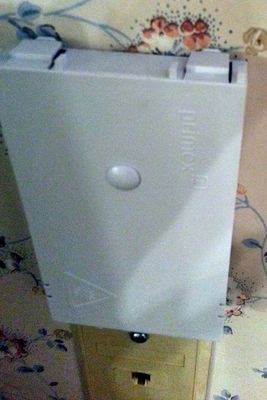

Fibre along with either Coaxial or Ethernet cable
I would appreciate advice. We are renovating a condo in downtown Vancouver that had fibre installed a couple of years ago. The condo was built in 1982, and has a suspended ceiling with 15 inches of ...
xray
2 years agoHero
What are you connecting to? Coax requires the purchase of MoCA adapters so Ethernet would be my recommendation.
