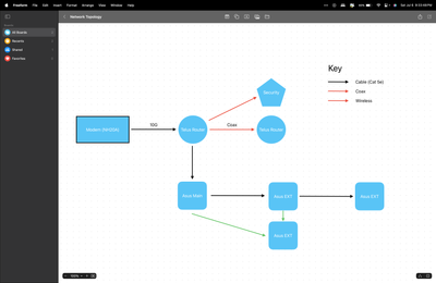

      Thanks for the reply. I've done what you have suggested and directly linked my ASUS to the 10G from modem. The speeds seem to be struggling as to before where ASUS was client of telus router. additionally, ipv6 addresses are not being assigned.
  • Its currently NH20A -> Telus Router -> Asus
