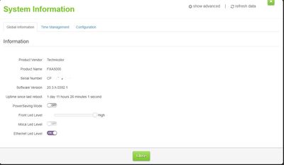

Now here is where the complication may come into the picture. TELUS has 2 very similar devices that they refer to as NH20A. First one is a Technicolor FXA500 and then the other is the Arcadyan NH20A
You need to make sure which one you have.

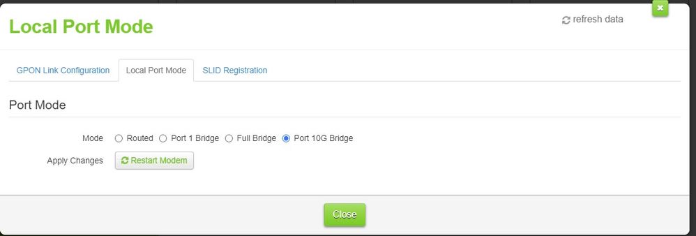

Instructions for the Technicolor FXA500.
To get to the setting that will allow you to change the modem into bridged mode go to the following settings.
Settings - Broadband Icon - Local Port Mode.

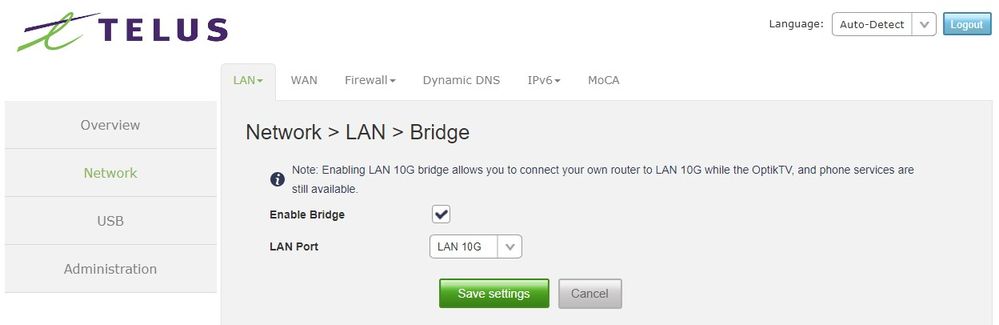

And the Arcadyan NH20A
Network - LAN -Bridge
I would set the bridge to use the 10Gbps port myself as that will support everything from 1Gbps to 10Gbps out to your 3rd party router where you can set all your network settings.
Hope this helps... Cheers...

And the Arcadyan NH20ANetwork - LAN -Bridge
Ahah! Thank you for this clarification. For some reason, I was not seeing that the LAN tab had a submenu, that has the bridge choice on it.
