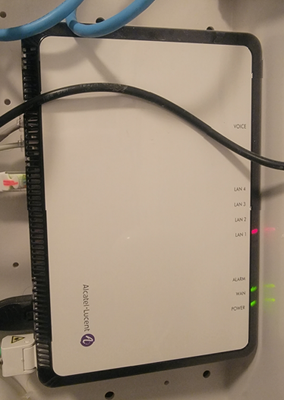

  • So i have the following modem connected to the incoming fibre.
    Prevoously I had the wifi hub
    attached to that. The wifi hub was then connected to a switch. From the switch we have 6 LAN cables heading into my wall. At least 3 of them go to the TV and 2 of them were connected to Telus wifi boosters.
    I switched out the Wifi hub and replaced with the Google mesh...which messed up the TV but gave me great wifi.
    I'm considering a splitter from the modem. One to the telus wifi hub and then onto the TV's and the other to the Google mesh

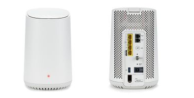

    • Nighthawk's avatar
      Nighthawk
      The first picture is an ONT. Normally you would either have the ONT + a T3200M, or the Wifi Hub, but not both. The Wifi Hub has no WAN port on it so the fibre would be directly inserted into it. Did you have a Telus installer come out and remove the Wifi Hub and install the ONT in its place? If no, then you had a Telus router there before. Did your IT guy possibly remove the T3200M? Do you still have the device that was connected previously? Can you post a photo of it?
      Are you perhaps confusing the Wifi Hub with one of the Telus wifi Boost units? They're not routers but wireless access points. They usually connect to a Telus T3200M, Wifi Hub, or the NH20A.
      Boost
      You also do not want to put a switch directly to the ONT as you are only alotted 2 IP addresses for the connection. Anything connected to the ONT has a public IP and is directly connected to the internet. If you have things connected wrong, you could expose your entire home network to the internet.
      Nighthawk
      The fibre ONT is typically the only device that would have a single port active. All that device does is converts fibre to ethernet. It's not a router. The actual router would have been connected to it. If you have Optik TV, you'll have one of Telus's routers there somewhere.
      If you have an ONT, it was usually paired with the T3200M router:
      ONT:
      T3200M:

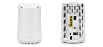

      If you don't have an ONT, then the Wifi Hub or the NH20A would have been installed and they have all LAN ports active:
      Wifi Hub:
      NH20A / FXA5000
      Which device(s) do you have?
