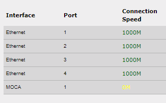

    If you have a PC directly connected to any of the four LAN ports, try the following:
    1. Go to the modem's admin page @ 192.168.1.254 and log in.
    2. Click on Status at the top.
    3. On the left menu click on LAN Status.
    4. You should see a table listing the four ports. Do the connected ones all say 1000M for the connection speed?

      Ethernet port connected says: 100m
      MoCA port says: 1340m
      Doesnt matter which port I connect to, always 100m. Triple checked cat6, no bad wires or connections (works fine oj MoCa)

        The modem has gigabit ports and it should automatically default to that. I don't know of any speed settings on the modem for those ports. It may be a problem with the modem itself, especially if there is no issue over MoCA. Get in touch with tech support and explain the situation and see if they may be able to send out a replacement.
