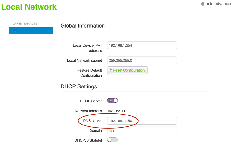

Is Pi-hole possible with Telus Boost Wifi 6?
There have not been posts that I could find since 2020 on this issue. I just want to confirm before I buy a new router that it isn't possible to get the Telus Boost Wifi 6 (the cylindrical white thing) to use another device on the LAN as a DNS server? This other device would be a Raspberry Pi running Pi-hole.
I have gone into the Boost web admin settings and I see that the DNS is listed as "192.168.1.254" which is the LAN address for the ONT. There doesn't seem to be an option to change this in the web interface.

      So I have changed the DNS entry on the ONT/NAH to the Pi-hole's IP Address: 192.168.1.150
      Devices seem to pick up this address as their automatically assigned DNS server address. However, ads are still not being blocked network wide. However when I manually assign "192.168.1.150" as the DNS server on each device then ads are blocked. This suggests that there is a DNS leak somewhere in the ONT/NAH. Is there anywhere else in the ONT/NAH settings that I must ensure that the DNS is changed?

        I have gotten Pi-Hole to work consistently now. To do so I had to do the following:
        • Disable DHCP on the ONT/NAH
        • Enable DHCP on the Pi-hole (making it the LAN DCHP server)
        • Add the local address of the Pi-hole as the DNS server on the ONT/NAH in "Local Network"
        • Disable IPv6 on the ONT/NAH in "Internet Access"
        Given that disabling IPv6 did the trick, I am assuming that was where the DNS leaks were coming from. I don't know what the implication of disabling IPv6 on my network is, but ad blocking seems to be working well.

      I will create a fresh Pi-hole installation and try entering its IP address into the DNS address in the ONT (also referred to as the Network Access Hub) and report back.
