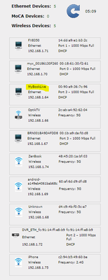

  • About all I can say is that I use a MyBookLive NAS device for backup. It is just plugged into ethernet and seems to work. This is what my device table looks like.

  • Does the NAS show up on the status page of the t3200, with an assigned ip address?

      It might - there are three "unknown" devices - I'm assuming the NAS would show up as "unknown".  I disconnected it and refreshed the page and all the same "unknowns" were still there.  Switched cables.  Started the NAS back up - no change in what is listed - so maybe not?

        Do you know how I would find the IP of the NAS?
