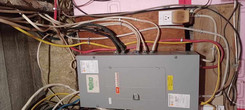

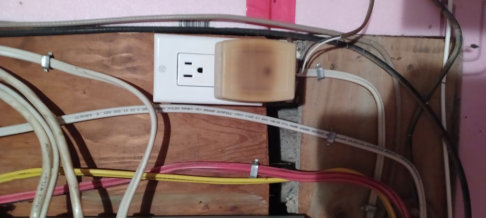

This plug is hot/warm. Electrician thinks it is connected to the security system and needs to be replaced. I am afraid of fire hazard. How can I tell if it is the security system and is it safe to just unplug it?
  • That is the ac adapter for the ADT Security system.  Mine is exactly the same and no problems.  It was changed years ago and now looks exactly the same so I left it.  The heat discolours it over time.  Probably why 99.9% of AC adapters are black.

    Hey Clottawa That plug does not look good. Where does the cable lead? To the electrical panel? Please call our ADT by TELUS team at 1-855-958-8181. Usually we want to provide help here but I want to be safe
